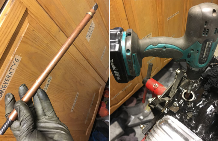

Here's mostly a tip for making an oil primer tool of sorts. A bit of allthread, I think it's
M10, but 3/8" UNC will work the same, and a piece of half inch-ish
water pipe. The pipe keeps the allthread from walking out off the oil pump axle.

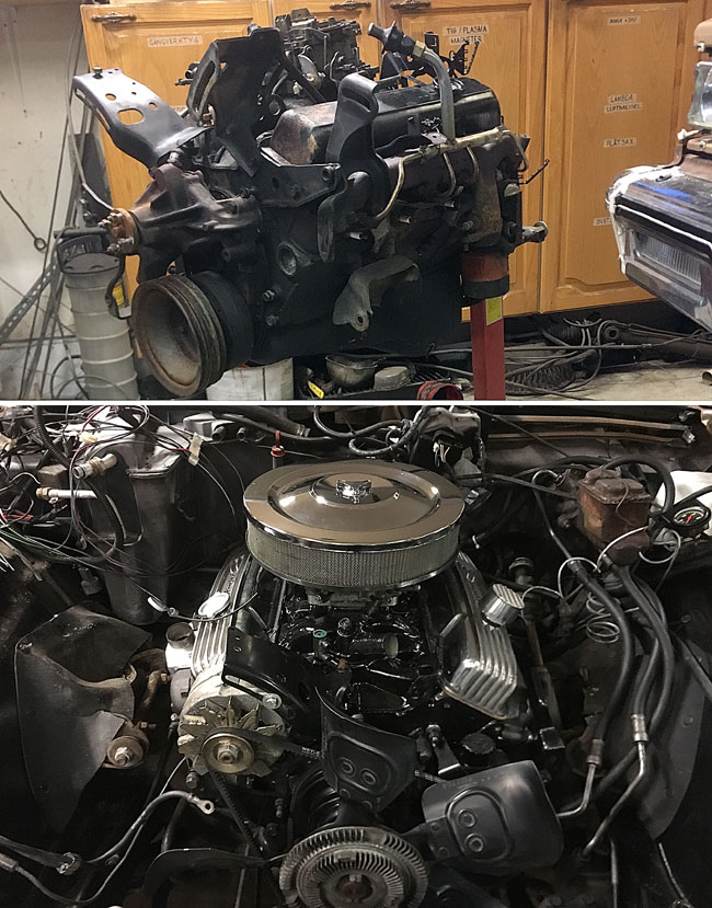

Continuing off my previous post.

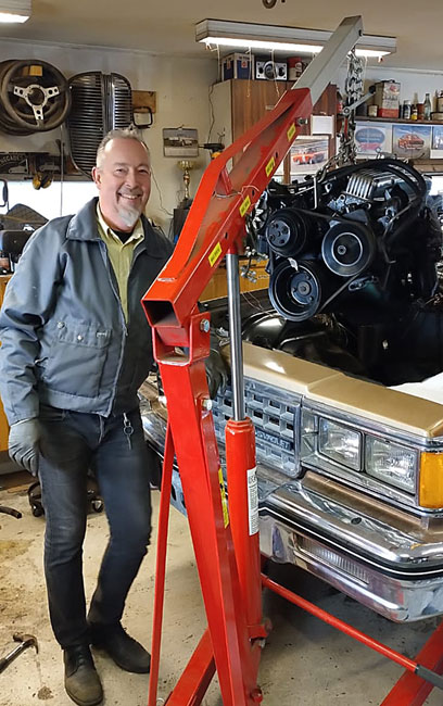

Your's truly hoisting a mostly optically refreshed engine into the engine bay of the Caprice.
Here's a before and after pic of the three-oh-five.
After removing a good size shopping bag or two filled with pumps, hoses, wiring and looms,
relays, air conditioning stuff. AIR pump, more hoses, the engine looks much tidier than it did before.
Paint and Edelbrock valve covers help too.
The ECU, electric Rochester Quadrajet and distributor are removed, and instead we have a
600 cfm Holley and a points distributor from the sixties.

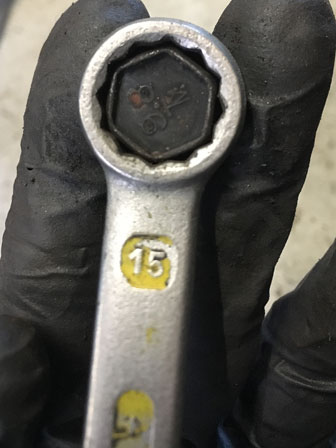

What IS this??? (torque converter bolts is  what they are) When you crawl under this 1984 Caprice, you have to bring ALL the tools.
I'm not used to working with metric tools on my cars, this was a surprise to me.
I've used 7, 10, 13, 15 and 17 mm sockets and box wrenches. Very... odd.

Anytime I change the engine oil on a GM car now...I bring the 15mm box wrench!

Essex, those engines sure look better when they are stripped down to basics! I remember '78/'79when Gm/Ford started that metric conversion.  Some were, some weren't, but yet still sae thread🙄  You had to have both sets ready to pull the sheet metal off. Finaly my Mac tool man come up with a double meteric/standard 1/4" socket set box cheap enough. Sure beat having to get both boxes out to dissasemble a front clip. Think i give $18 for the new empty Mac box.

Nice engine swap Essex. 👍

Thank you Rattiac!
Though it's not really an engine swap, I just checked a main bearing, washed the oil pump,
put in new crank seals, and cleaned it up.

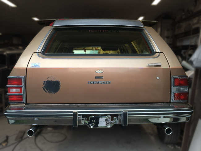

I finally got the new exhausts done on the Chevy. This whole car was supposed to be done in a
couple week,s but... No.
I found a pair of exhaust tips for a Volkswagen for about $20 and cut them apart. The black hole
in the paint on the tailgate is from me removing a big round 80-decal. This wagon is registered
as a light truck, which was a way to get around car tax in Finland in the eighties and nineties.
With a light truck you weren't allowed to drive faster than 80 kph ( 50 mph). Today the
maximum speed is 75 mph for all cars and light trucks.

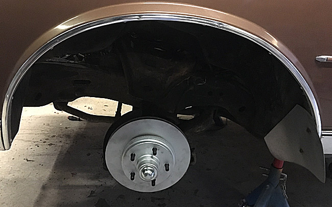

New brakes in the works too.
I found rotors for a decent price in Germany and ordered them the same  day as I ordered a bunch
of stuff from ROckauto. Funny thing is the parts from America arrived in less than a week, but the
German parts took ten days.

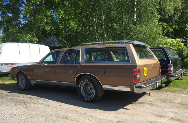

Sure like to have a set of 10" Rallys like you have on the back. (At least they look 10" wide in the pic)

Yes sammons they are 10" wide, they're cheapo fake rallye wheels, but they do look
great on the wagon.
I gave up with the hydroboost and ordered a new vacuum brake booster from Rockauto, along
with some service parts for my points distributor. Brakes are now just perfect.
I finally got the Caprice mot tested last friday, so now it's street legal and on the road for the
first time since 2007. It drives like no boxy body GM car I've ever had, and I think I've had 12
of them. Feels like driving a Cadillac (though, I never drove one, so just guessing).

Nice looking wagon!
