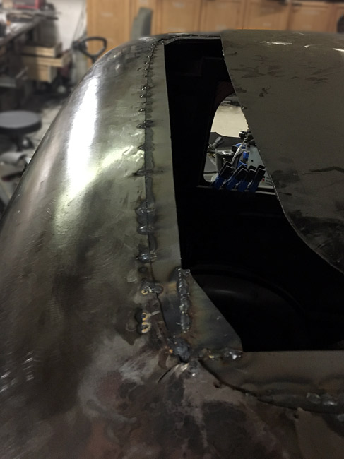

The front strip is tacked to the front of the roof, over the windshield. and the
bead rolled strip along the side, is held on with various clamps.
Here the side strip is welded and ground. As the glue will cover the edge, I
decided that it wasn't necessary to finish weld this, just tack it fairly heavily.

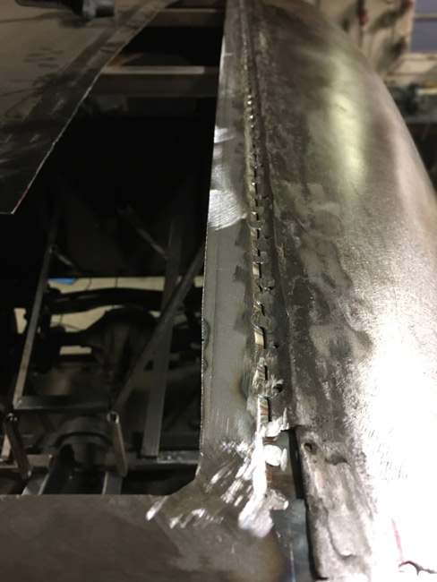

Top view. The strips will make for a nice surface for the adhesive to
adhere to.

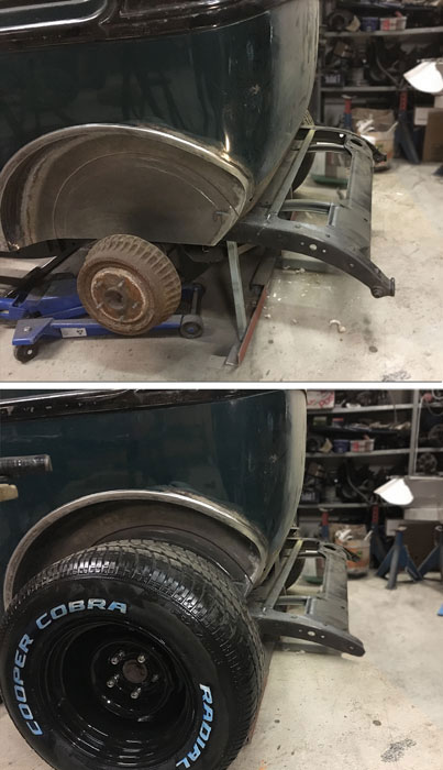

As the mounts for the aprons are easiest to make before the floor goes in, I cut eight
pieces of 1/8" sheetmetal and drilled a hole in each to make apron mounts. I intend
to mount the aprons on the side of the frame, insted of sandwiched between the
frame and the body, as per original.

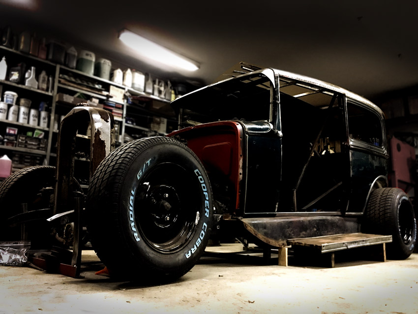

I had gotten concerned about the whole car being too tall, it's 67" after all, but the
running boards are right about 4" off the ground in the front end, so I think that
will look good for a normal ride height.
Lots of work with those aprons and fenders...
