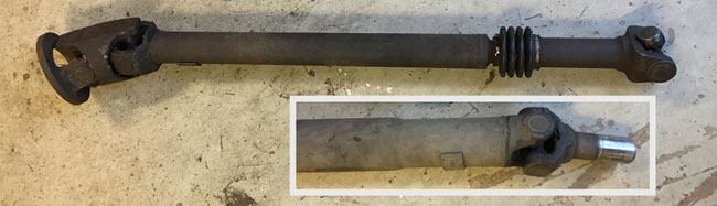

 The other day I happened to find a prop shaft for sale here in the very
village I live in. it's from a Dodge Ram, and it's the front prop shaft. Since my
transmission (6-speed manual) has a flange rather than a slip joint, a front
drive shaft seemed like a good idea.
The prop shaft needs to be lengthened about 4" in the right end in the pic, and
the yoke will be taken from the Chevy Caprice prop shaft in the inset pic. The
rear axle in my Buick is off of an S10, do same universal joint. This is left to a
fabricator now.

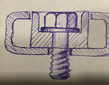

I'm planning to get six of these done:
Body mount thingies to weld into the cross braces that connects the body to
the frame.
They will mount like this:

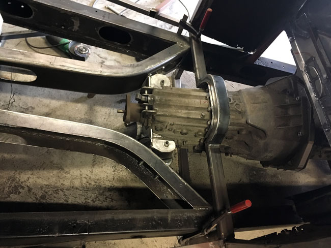

Two of those tubes are cut for the transmission and prop shaft tunnel, and
need to be reconnected to get back som of their stiffness.
I bent one of those connector pieces tonight, and it goes on top of the
transmission, right between the A-pillars.

The bent crossmember connector (actually built from 1/8" thick sheetmetal) was welded in today,
after adding flanges to it. The trans tunnel will be welded to those flanges. The tunnel will be pretty
tight, as I'm going to have to squeeze in three pedals. There's about three eights of room around the
transmission in every direction.

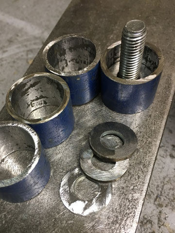

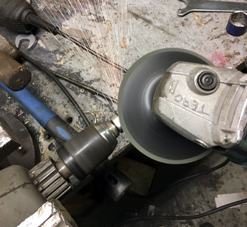

My technical drawings didn't amount to much. I started thinking that it was all too much hassle to
make someone turn the parts, and wait for them and also to pay for the work. Yes I'm cheap. and
want to continue when I'm up to speed. I found a piece of water pipe among the junk under my
bench, and cut pieces from it. Then turned thick washers to the right size, using an epectric drill
in the vice, and a grinder to turn them to a suitable size. Welder to zap the washers in and: Voila!
I cut a hole in the crossmember with the plasma, insertred the body mount, welded and ground.
I left out some adjustment grinding and such, but in any case, the end result is what I wanted; a
flush bolt head that  can be reached with a socket.

More turning down washers to fit inside pipes. The electric drill working
against the side grinder.
