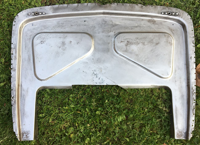

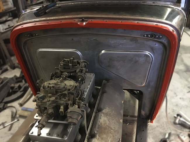

I finally got the firewall welded and ground today. "Finally"... I have to decide what to do with the bootom edge
still, so it's not exactly done yet.
The radiator stay mounts are turned back and welded in now too, and all holes filled.
This is what it looks like when I rosette weld the spot wolds with mig. The holes are 1/4" and the mig is turned
up pretty high, to get nice penetrating welds that are fairly flat.
After grinding the spotwelds the new spacer and the front edge of the cowl got a coat of red primer.
The firewall is just stood inside the cowl in this pic. It's a bit low, but otherwise in about the right place.

Finally (again?) got the firewall done! I'm not certain about how the bottom edge needs to be done, because
I don't know how to route the hoses and tubes to the heater, but I decided to do things this  way, and if
needed I'll make the necessary modifications later. One can't leave everything half-assed and almost-ready.
So now I have someting to weld to the cowl, and to start building my floor and transmission tunnel off.

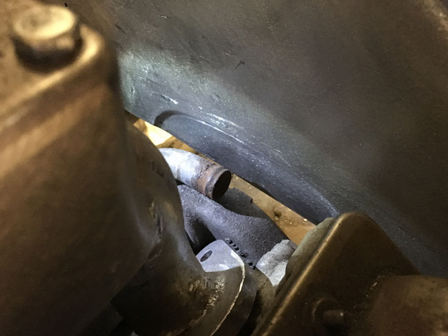

The little impression or stamping  a bit off center just above where the top of the transmission tunnel
will be, is for the heater return hose, behind the intake. Like this:
Room for a hose clamp and all now.

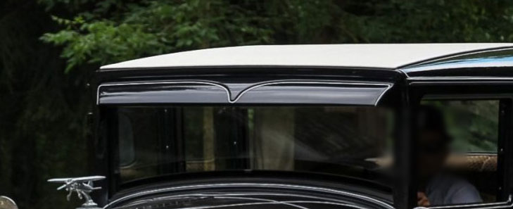

« Reply #72 on: September 29, 2022, 02:53:14 AM »
Thank you all for the positive comments!
Fun thing with the visor: Inside a week of my getting it done, a friend sent a pic of a 1929 Oldsmobile for sale, and asked if I was interested. It had a very similar shape in the center. I thought I had a totally original idea.
(Sorry for steaing this pic off the net)

Finally! (for the third time) the firewall is done.
Since the frame is bent up a foot or so behid the firewall (to make the front suspension work good at my planned ride height), I had to cut some off the bottom edge of the firewall so it won't touch the frame. Then a squirt of primer to keep it from rusting.
Hoping to have time to weld it in still today. It will be welded with rosette welds to the back side of the 1" spacer tube.
Nothing short of amazing what some paint can do.
I think I will have the firewall done a 4th time today. Maybe.
« Reply #74 on: September 29, 2022, 06:34:10 AM »
Not to be disrespectful in any way, but that crescent was used a lot, Chevrolet used it on the 32 fenders
