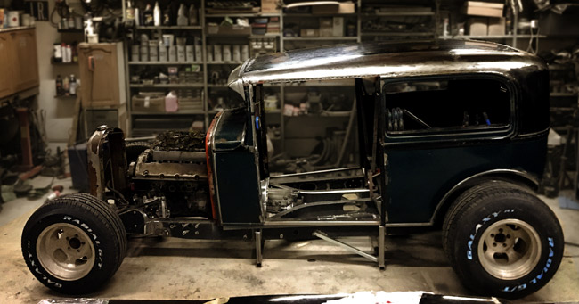

I got the new tires mounted on the slot mags a couple hours ago,
and I'm really stoked. I like how it looks now better than before.
It looks more compact.
You might notice the stands under the frame. It's still all bolted to
the floor, so the frame and body are rigidly mounted to a fixed
height. I just lifted the axles some to accomodate the bigger wheels.
By the way, those 9" wide front and 11" wide rear mags are off of a DeTomaso Pantera, that a friend of mine
modernized with big inch rims.
The way I roll is on 15" wheels.
