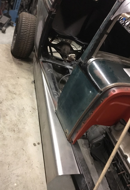

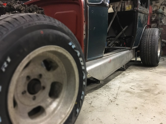

Aprons on the to do list today. I have the driver's side one
done for now. In time I'll continue working on them when it's time
to get them to work with the running boards and fenders. Right
hand side apron is cut and ready and all parts made, but the
mounts still have to be welded to the frame and the apron
itself mated to the mounts.

much energy left for work on the Buick. I got some work done on the right
hand side apron, though, the mounts are welded to the frame. Mounting
holes still have to be drilled in the apron, so not done yet.

I played around a bit and tried the rear wheels in the front. It makes for
a very special look with 375/60-15 tires. I got inspired and did a kind
of a half assed concept to try the idea. Big tires all around, front half
fenders, rear fender faired into the running board, and pulled out in
a drop shape like an air plane landing geat spat. Front wing, and
probably a diffuser in the back.
Funny how low the roof looks, almost as it would be chopped an
inch or two.
