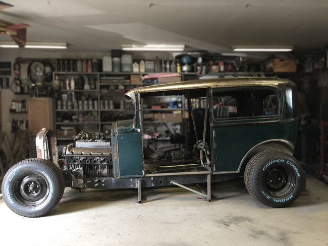

When the body sat on the frame I noticed that the engine now sits quite a bit farther
back than I had originally planned. This is because the steering took up way more estate than
I had figured.
When viewed from the side, the problem is obvious. The aesthetical balance is way off, as the
engine sits so far from the grille shell and all the way into the fire wall.
On closer inspection, the problem seems pretty minor, but it gets worse. The body needs to
get moved forward another 1-1/2".

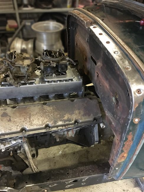

After a lot of drilling, and a bit of work with both the air chisel and he manual one, the
firewall was out.
The ignition coil is a Mallory one. I assume it's stock and original to this car, at least it looks old. Mallory
sounds like speed parts to me, though.
Probably not a bad idea to have the coli inside the car. I think coils are a technical part that look good
showing in the engine bay, so I'll probably mount mine on the outide of the firewall or on the intake
Now I got to move the body forward to where it will sit. As I was afraid, just flipping the
firewall is not enough. A 13/16" U-profile between the front of the cowl and the firewall
will do the trick.

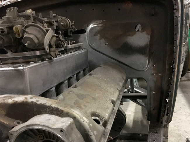

This is how the firewall looked before cutting it out. The black mark on the right side shows
how I plan to reshape the recessed "panel" which of course will be proud of the firewall
when it is flipped. This shape will leave more room at the valve cover and cylinder head.
