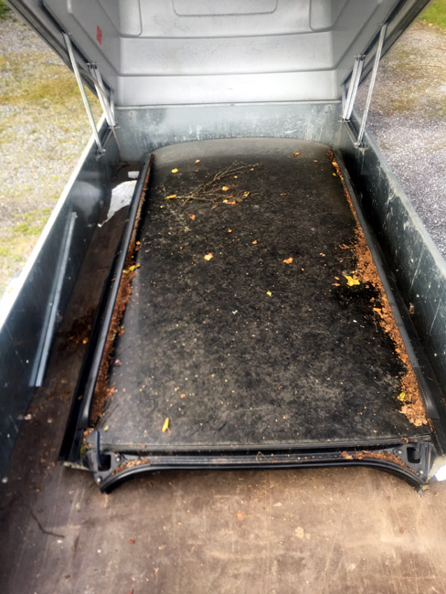

Since I live far north and summers are short, I had planned to go hunting for a roof, and this
was as good a time as any. After measuring the crown and size of several wagon roofs, I decided that
a Volvo V70 roof has about the right amount of crown to it.
So, out with a bunch of extention cords and the 9" angle grinder and off we go. The rear hatch was
gone, and I was allowed to smash the rear side windows, so it was easy work. The Volvo side curtain
air bags are inside the roof, so I didn't even go close to them with the cut off wheel.
The Volvo has a Saab 96 hood on it, which gives it all an odd look.
When at home, still in the trailer, the flat part of the roof was cut out, leaving just the
frame to keep its shape.
