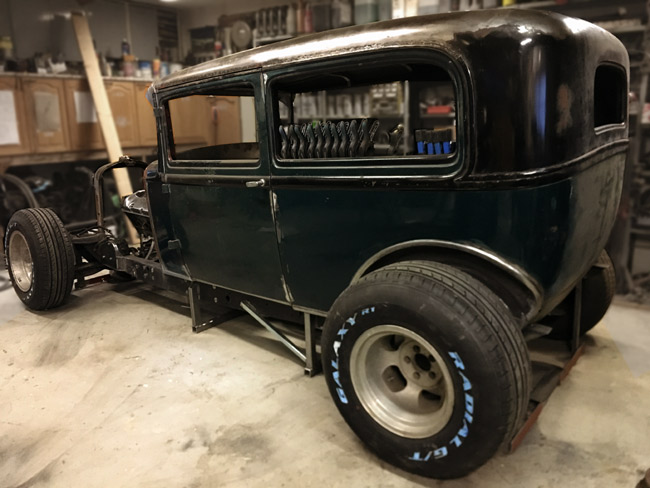

I mounted the driver's side door today, and surprisingly, it made the body look longer. The door
has been off for almost a year now, so it looks unfamiliar in a way.
Funny how the eyes get used to what you're working with.
I assumed the door would hover above the floor level, but with the floor panel sticking out
under the door, it won't shut.  I guess I have to adjust my plans for the door sill/treshold some.

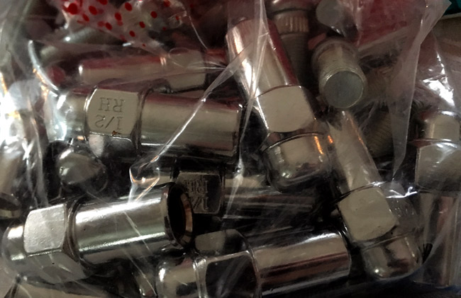

I got a nice little package in the mail. I finally got the wheel nuts and studs ordered, they
arrived the next day, fast delivery! My Chevy drive shafts will be re-drilled for five on 4-1/2"
bolt circle, to make the mags fit.
Also, I can get the fronts bolted on, as I now have nuts that fit.
Oh, and the S10 rear axle gets half inch studs instead of 12mm.
