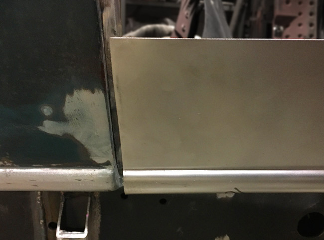

Rust
is also a thing, still, a few spots of that kind to attend to. The bottom
of the cowl area is a bit crusty, so that's best taken care of now, because the plan
is for the floor in the front to attach to the new part. There's like a little shelf on
the inside to rosette weld the floor to.
Here's the "before" and the new part welded in. Actually parts, because I couldn't
make it in one piece. Then ground:
I'm pretty pleased with the result, but it alos took me quite a few hours.
The other side is worse, rusted higher up the side, so a bigger
patch part is needed.

After taking a deep breath, I decided to make a whole new bottom part, bead and all. I don't have a bead
roller big enough for this kind of work, but got an idea, and cut out some 19 gauge sheet metal, then
made a bend in the break:
I then bent the bend back, and it rolled over to about the right shape. I put a tube in the vice, and
rolled a round shape to it, just manhandling it:
Two inches longer and I probably wouldn't have gotten it bent.
Another break in about the right place. It was a bit tricky to get the break tight enough, and in
the end I had to make the last break just hammering it into submission.
Finally the little shelf for attaching the floor on the inside, was cut to a suitable width.
The end result looks similar enough to the original, so for now, it seems I can use this patch panel.
This is a situation, where I think it paid off to decide to make a fairly big patch, instead of cutting
just barely the worst rust out, and make like five small patches. We'll see.

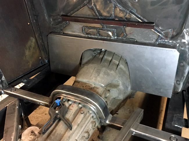

Now that the rust in the cowl area is taken care of, work commences with things that have to be
done to get the floors in. Obviously the firewall has to be done first.
I cut out a piece of sheetmetal large enough to cover the opening in the firewall, leaving it
about
5
8
" over size in all directions, and then made a carbdboard template
for the transmission bellhousing.
The sheet metal piece had one edge bent about 45
o
into a flange of sorts, to fit the
opening, and the bell housing hole was cut according to the template.
The opening for the transmission was cut pretty tight, as there's not too much space for
three pedals. A flange about
5
8
" was bent bith a tipping die on my little bead
roller, and using the stretcher I got it pretty flat. Same thing around the sides, the same kind of
about
5
8
" wide flanges.
Finally a bunch of holes were drilled in the flanges, and the whole ting was rosette
welded to the firewall.
Actually, the bottom flanges (red arrow) were bent before welding the panel to the firewall.
Now this new flange has to be connected with the one that is part of the patch
panel I made a few days ago. This is fun and straight forward work, much
more fun than patching rust holes.
