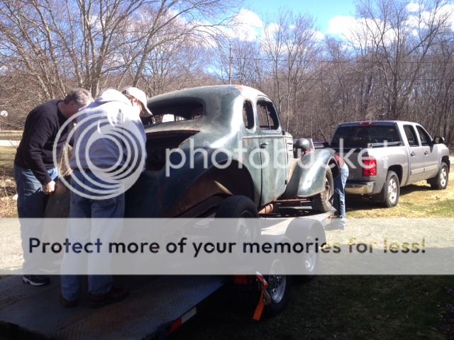

Looking forward to both my project and time here on RB. I picked up a '36 standard on Saturday that has been garaged and not running since 1970-1971. The previous owner bought it in 1970 at the age of 16 out in Minnesota. He replaced the drive train with a '58-'59 283 and a 3 speed and rear end from a '55 chevy doner. Uncle Sam came calling and the car was never touched again. I have a few questions right off the bat but I will start a new thread....mostly pertaining to running boards.
Here was part of my day on Saturday.
Chuck

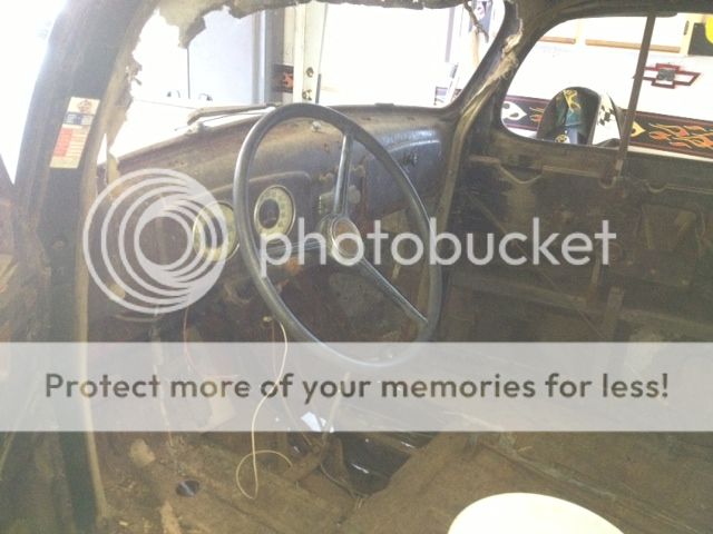

Hey Chuck welcome to the bowtie from ColoRodo. That is a nice solid project it even has a lube sticker still on it. You said the wood is good, I would not take it out but just work around it for the most part because of condition of the wood and the way it is installed, it would be a task to remove it with out hurting the body ar the wood. I have a friend that is also named Chuck that had a 36 coupe and he regrets selling to this day. Again welcome and have fun here....John

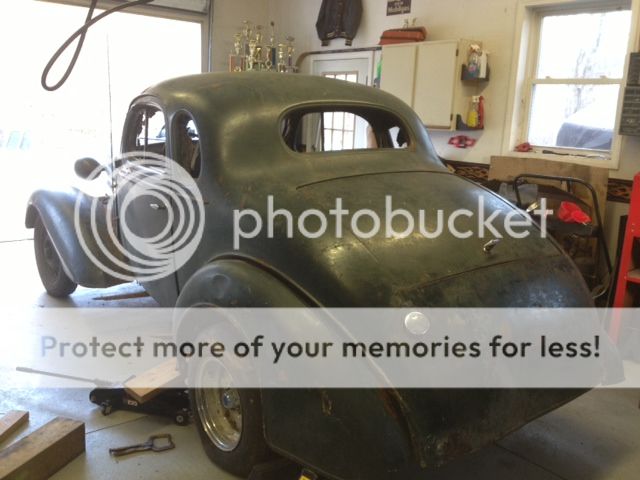

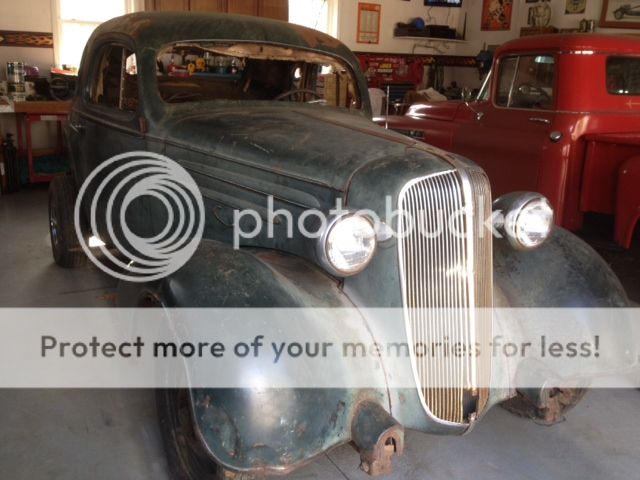

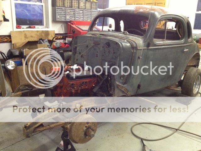

I really got lucky with the condition of this coupe...it should make the build go a lot quicker. There are only a couple pieces of wood in the doors that I may replace but everything looks pretty good. Maybe I'll take some pics of some of the wood. So If I understand correctly the only place for the VIN is right by the battery box....looks like it may have been mounted on an angle....it is gone. I do have the tag on the firewall but the VIN is not on that correct? Is their a source for decoding the VIN that would give me the number of characters in it. I was off today and made some progress on the coupe. Give me a second and I'll be back to upload a pic.
