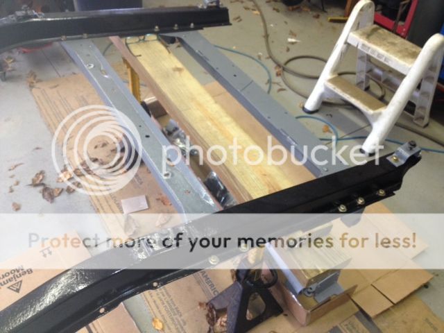

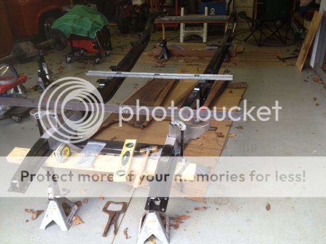

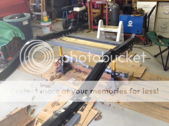

With the body off the frame, the frame has been sand blasted, mostly painted and I am in the process of installing my Fatman MII kits, Chassis Engineering rear end kits and my Chassis Engineering tranny and motor mounts.
  • Age: 66
Re: New Member Intro-'36 Standard
« Reply #42 on: November 07, 2014, 08:33:08 AM »
Hey Chuck, that frame looks real nice and it sounds like you are going state of the art.

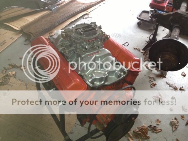

Engine was frozen.....I ended up selling it to a guy who wanted a matching 283 for his '59 Apache.  Ironically enough I bought back a running 283 which can out of my '59 apache which I sold to a friend for his '57 Chevy Truck about 3 years ago.  He never got around to installing it and has been sitting on his engine stand.  MY '59 Apache currently has a 383 in her.......
And here is the 283 I am planning on putting in the coupe...

Nice work! I wish my frame was derusted and ready to go. I'm not a big small block fan, though I have 4 vehicles with 350s, But I make an exception for 283s and 327s. I can't explain it. ::)
