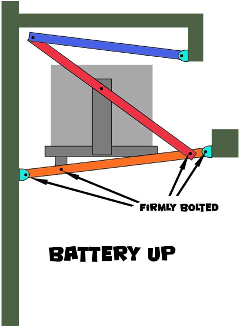

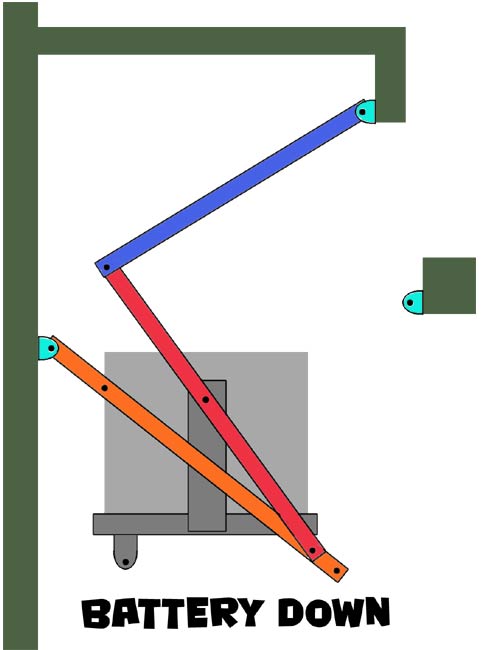

sixball, you asked about my battery mechanism. I drew a sketch to
explain how it works. Here's the principle, same thing on the othe side of
the battery.
Obviously the battery itself is bolted to the tray.
This works, but to get the battery up, I need to use both hands and a knee, so
some kind of hook or latch thing is needed, so still in the R&D stage.

So many good ideas in play here. The battery hider is really cool. Thanks for the drawing.

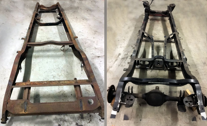

So now the frame is bare. I found a pic of the frame right before I got it sandblasted a couple years
ago, and if you look closely, you might see a difference. I'm looking forward to taking pics of the
finished frame with engine, transmission, suspension, wheels, prop shaft and exhausts.

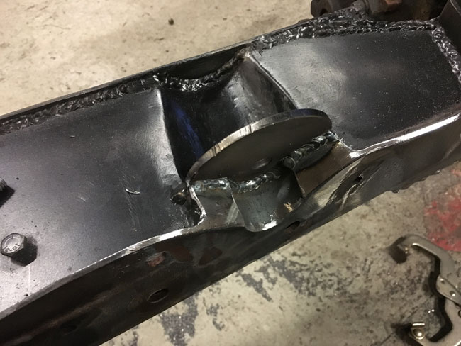

I finished up the engine mounts, figuring they'd be easier to weld nicely when I can move the
frame around freely. It took a piece of 1/8" wall water tubing and some  small pieces of the
same thickness plate, to make them ready.
The 1/4" thick round shaped engine mount plate that looks like it's just welded to the boxing plate, is in
fact not round, but welded to the inside of the frame, and it also has wedges that are welded to the frame
flange under it. The box plate is molded around the mount.
I use Volvo 740 transmission mounts for both the engine and transmission.

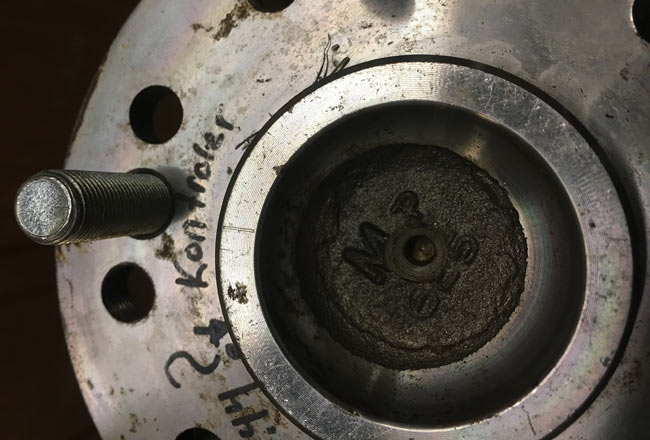

I have Moser drive shafts with C-clips. I'm wondering if this will really work, the surface
for the wheel bearing is pretty darn coarse, just like turned on a lathe. Is this normal on
a new axle shaft?
Hard to see in a small pic, but it's not at all like bearing  races usually are, almost with a
mirror finish. Would anyone of you have any experience with this kind of thing?
Here's a pic of the end of the axle, just for reference.
