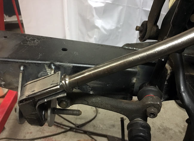

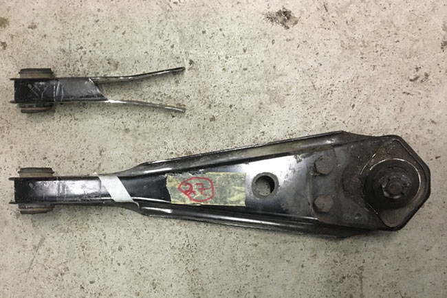

Keeping on trying to finish the frame. Now it's time for the strut rods that have
to be modified to fit. Starting with a couple old Mustang lower control arms that
I bought at a swap meet,  I decided to use the inboard bushing to make what
effectively is an extended A-arm.
I first cut away most of what I don't need.

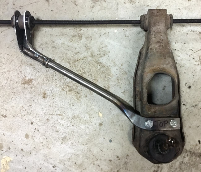

Then made some brackets. They're two slightly different sizes, because the frame
slopes downward towards the back.
The length of the whole assembly is dictated by the idler arm on this side, and
of course, the pitman arm on the driver's side. Brackets tacked in place in this
pic, still working on the strut rod end.

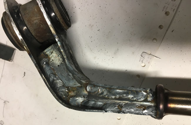

Here the strut rod end is tacked to the rod itself. The aim is to keep the bushings
aligned to make for a smooth moving assembly.

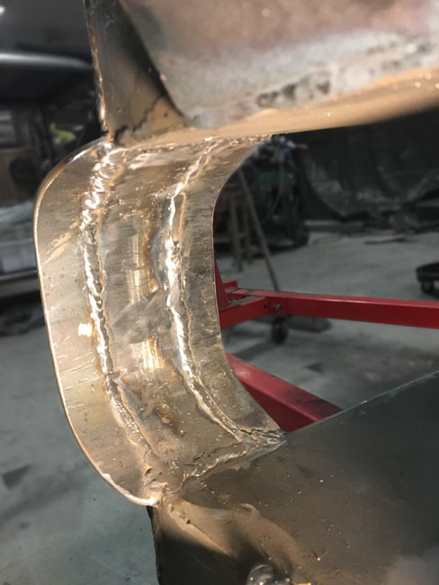

This pic shows how I made the thing compression resistant by welding in a crush
preventing part in the middle, made from 1/8" plate.
Finally the whole thing was clad in the same 1/8" plate, welded
and ground to a smooth finish

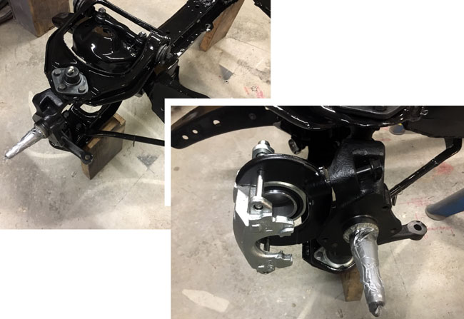

A few bits done, new balljoints and bushings in the control arms. I also trial fitted the adapters for the
GM G-body/ Camaro/ S10 brake calipers to mate to the MustangII spindles, so that the 11" Granada
brake rotors will fit.

First time trying to fit the adapters for the GM calipers and Granada rotors. It's fun when
parts from three different cars just fit perfectly.
The Ford brake rotor is slightly thinner than the GM rotor would have been, so for piece
of mind I'm going to make a shim to go between the caliper piston and the brake pad.
