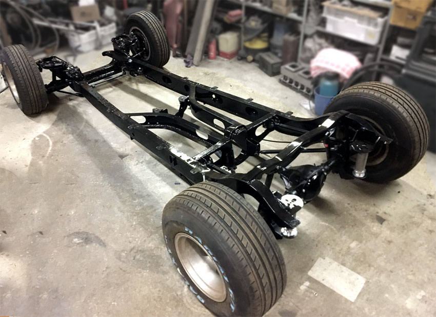

I got new bearings, seals and drive shafts mounted, then got the oil filler plug
out (after weding a bolt to it).
Then got  the rear brakes done and adjusted.
I had to watch a good video on youtube to get the springs right. Last time I built brakes
like these was last spring, but I had managed to forget how I did it.
That done, the right hand brake rotor  with new bearing and all was installed, and
suddenly we have a roller!
Getting the project down on the floor standing on its own wheels always feels like an accomplishment

« Reply #316 on: March 02, 2024, 12:04:50 PM »
Looking good.  Gonna be like a brand new car.  👍
« Reply #317 on: March 04, 2024, 03:03:02 PM »
Thank you Rattiac. It's fun with new parts. When I built the Essex I didn't have any money, so all parts were
used, good parts, but used. I put in s new rear brake cylinder and a repair kit for the brake master cylinder, not
much else. Budget was slim&tight that time.
I got all three brake hoses done yesterday. I should have welded those in before painting the frame, but I didn't
think of it then.
I bought a couple 5/8" box wrenches and cut them down to use as brake hose moutning brackets. This works
very well, and was fun, compared to filing holes to fit the hoses
I had been planning on painting the transmission, but it turned out pretty nice just cleaning ithe dirt and crud off with an assorment
of rotating wire brushes.
I also mounted the slave clutch cylinder. I'll change the oil,then it will be ready for installation.

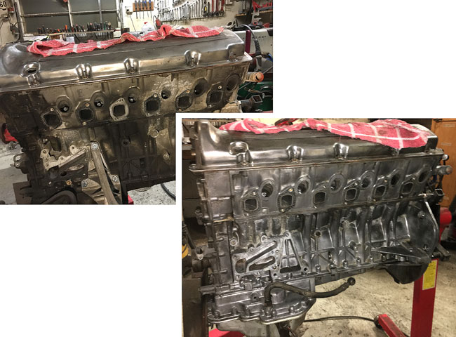

I spent a couple hours cleaning off most of the dirt off my engine thursday evening, efter getting it
bolted to the engine stand the night before.
It's a ton more work that to clean up a chevy small block, there are so many small shapes in the
block and the heads, it's taking a lot of effort to get it clean, probably three hours was spent after
taking  the after pic above.
I dropped the bottom part of the oil pan to clean it out and check how bad it looked inside. Not
very good, but with some luck, the engine might be serviceable.
Tomorrow I'll probably go get a couple of those rotating nylon abrasive wire brushes to scuff the
block and heads with to give the epoxy something to grab onto. Before that I'll do some engine
work, cleaning the vavetrain some and flush the engine with some oil and diesel and ...
We'll see.

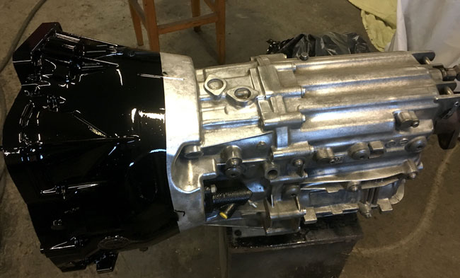

A few days more of cleaning the block and various parts, I stirred a batch of epoxy and sprayed it on.
The engine looks funny in light gray, like an Iveco marine diesel. Transmission bellhousing was epoxied
too, as was the engine to trans adapter and the intake.
Then the next day, black automotive 2K Glasurit high gloss paint.

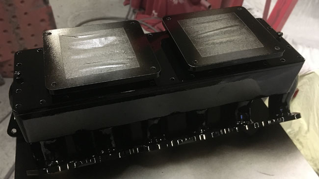

The intake looks very nice  when painted. Before painting I welded in a longitudinal divider in the center
of the intake to avoid the adjacent intake runners to steal the air/fuel mix from eachother.
The bell housing was painted where it shows when you look at the back of the engine with the car assembled.

« Reply #326 on: April 05, 2024, 06:19:53 PM »
I had to get help to get the transmission coaxed all the way into position. Even then we worked
quite a bit to get it done. I must have gotten the clutch plate a tad off center.
