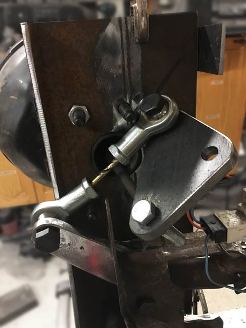

, I had this brake booster and pedal assembly from an '87 TransAm. It's been
warming a shelf for 12 years, so, even if it was angled weird, I decided to use it.
Plans changed many times when I was planning and pondering. It took me a few days to get to the
point when I decided this has to work.
I turned the brake thing backwards (looked like a boomerang made out of 10mm thick material in my
last post).This gave me a 32 degree angle to work off. Also the brake booster sits at a 13 degree angle
upwards. I was planning on mounting it horizontally, but the G-body master cylinder I ordered
earlier has an angled lid so if I would have mounted it horizontally, it wouln't have held much fluid.
I wasn't feeling confident at all, when I started working on the brackets for the angle thingy, that
turns the movement from the brake pedal 90 degrees, and is angled 13 degrees in one
direction and 32 in the other... Overwhelming might be a suitable word.
I made a cardboard template, and started cutting and drilling. It semed to do the trick, so after that the
rest of the work wasn't too hard.
Today I got the whole thing almost ready to weld to the firewall. I made bolt on/weld on brackets, so the
assembly can be removed with four bolts. I'll probably make a bracket with one or two bolts at the
dash. The brake booster and master will also get a mount, so they'll hang off the center of the dash.
The whole thing is a monstrosity, but I think it will work. The movement at the brake booster is
the same as when originally mounted in the TransAm.

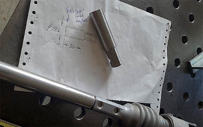

I worked a bit on the Dodge brake mount and made a flange for mounting the master. When the
actual brake pedal and its mechanism is mounted, I'll make the cluch pedal fit in the car
and maybe make it a part of the brake pedal mount.

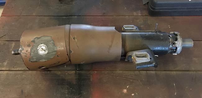

I cut down an eighties Buick steering colum with tilt as small and short as I could.
Funny that you still see a bit of the ignition lock where I ground most of it away.
I had a friend turn and mill the missing part for my steering shaft. The new part here welds
into the column, and the other end fits my Mercedes U-joint.
This is now welded, so the steering just needs a bit of finageling to make it fit and work, and
then some brackets and mounts.

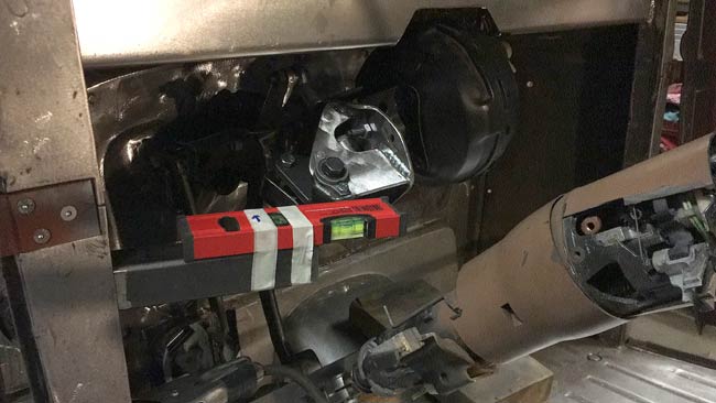

I welded the new part I had had made a few days ago to the steering shaft of the cut
down tilt column, and hung a ?56 Chevy steering wheel from the roof in about the right
position. I take all the ergonomic measurements off my '84 Caprice, since it's
pretty comfortable.
Then started working on a new piece of square tubing that will go between the A-pillars.
Level taped to the tube to get it right.
After the tube was in (it's decently sturdy at 1-
5
8
" square with
8
" walls), I started
mocking up a column drop from
8
" plate.
The column drop turned out to be about right, so I might be able to actually use it.
Some time in the future the tubing and the other unsightly stuff will be hidden by a later era style dash.
