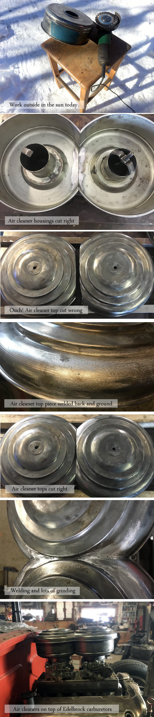

Thank you chopper 526. I have a thing for those old oil bath air cleaners. I had
something similar on my Essex the last couple summers, an old oil bath air cleaner
 that I found in a junk yard in Canada.

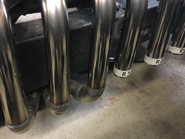

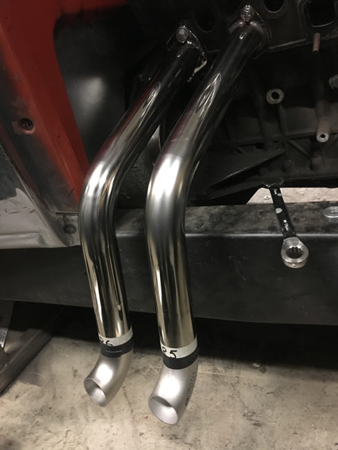

Here's the first try at making a flat merge collector. There will be four of these three-into-one
collectors, where the primaries turn back in under the frame. They will continue in a short, maybe 4"
pipe, that goes from flat to a round 2-1/2" collector flange.
There's not enough room for round collectors under the frame. That's beside the point, really, this is much less work.
This would be much easier to do...

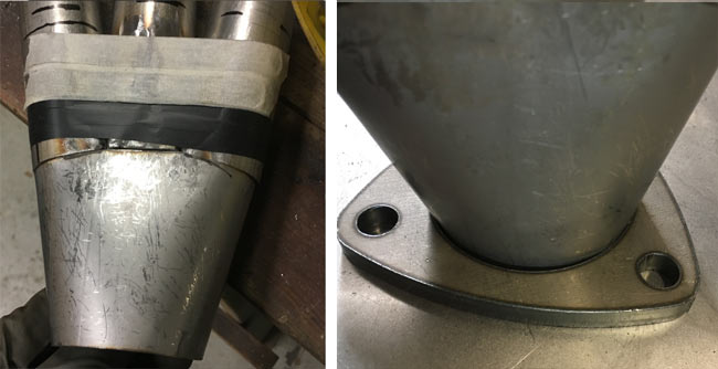

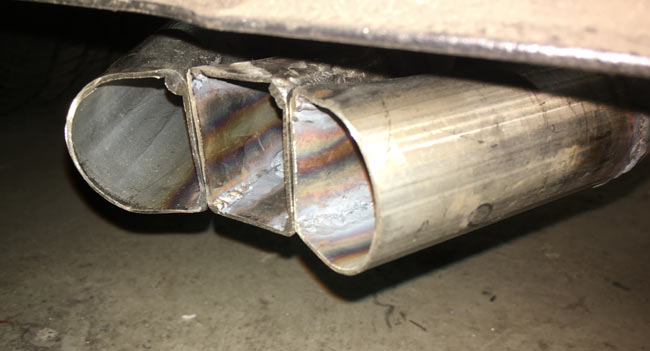

I got a few hours in the shop, and got work on the first collector started.
I fought with the stainless, and even at 1mm thickness (40 thou) it was hard work, and I feel that
thicker material would be  the way to go. So I'll try making them in two parts, probably, and thicker material.
I got three primaries merged.
It took me some thinking and planning to get this done. I don'treally TIG, so this was a challenge,
but it seems it can be done. Just four more to go.
An extra cylinder head would make this work much easier...

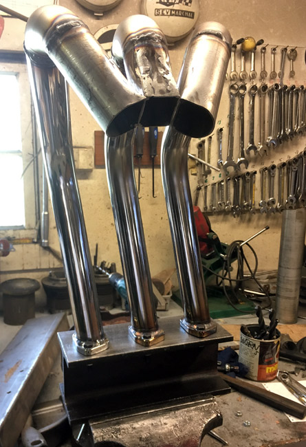

I just got in a day to work on the headers. I decided that a jig is  the way to go, so I measured the spacing
 and drilled six holes in a short piece of H-beam to bolt the primaries to. Then (after I took the pic) I welded the
primary tubes to eachother, and made the parts for the collector. Stainless is very hard to form, maybe I
should have gone for thinner material, I'm making them from pieces of 1/16" wall tubing. As this is the
first one of four, I might still try to find some thinner stainless sheet metal.

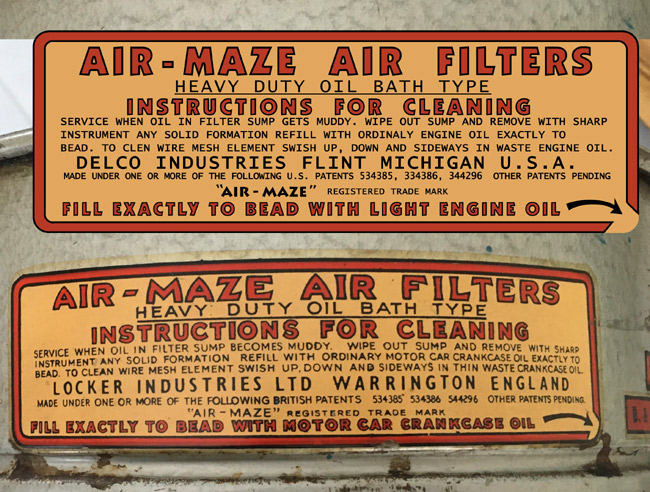

Late one evening I got inspired to draw new stickers for the air filters. I beleive they are from some kind of
Brittish trucks, but since I'm planning on making the engine look somewhat American, I changed some
of the text to make it look like the filters are American made. Just for shi#!s and giggles.
I will have some stickers made sometime down the line
« Reply #237 on: July 28, 2023, 03:57:14 PM »
Amazing work on the label!  Looks great!
Headers are coming along!
