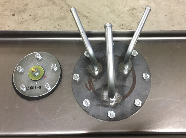

Fuel pick up, vent and return lines in a home made lid. Inside the tank there are thicker pieces of sheet
metal, which are threaded for the screws.  I made gaskets for all openings from 2mm thick fuel proof rubber
The fuel tank trial fitted. It does fit with only a few fractions of an inch to spare.

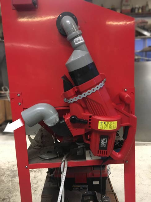

I took a day off from the tank work. As it's going towards fall and I have planned to get my A-arms
and other details sandblasted and painted during summer, I had to invent some kind of
exhaust fan for my blasting cabinet. I tried using my garage vac to suck out
the dust, but even via my home made cyclone, the filter just clogged up.
Last night I had a a light bulb moment, and so today I bought the cheapest leaf blower I
could find, and some drain pipe, for the grand total of about $50. Then got home and cut
and heated plastic parts until I got the mismatched parts to fit together.
This is how it looks now. the white arrow shows where the dust is blown out. I'll connect
it with a 3" hose (thin walled plastic with a meal spiral holding the shape) that
in turn is hoseclamped to a pipe that goes through the garage wall.
I sealed some seams with caulk, so I'll do some test blasting tomorrow.

sixball, I used a shop vac too, it worked ok, but even when I used my cyclone, the dust
went through and clogged up the filter in no time. Almost all vacuums and all fans for that matter,
uses the air they suck to cool the motor. A leaf blower doesn't, so I am counting on getting some
lifetime out of it in this use.

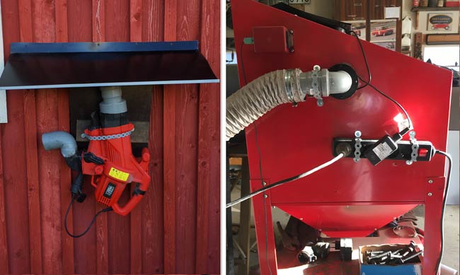

It got dusty in the garage, and the only way to not get vacuum all the way inside the garage was to
put the leaf blower outside the wall. Now it works great, and as a bonus, it's much quieter too. Now if I
could only get it to run a bit slower, the vacuum is so intense, that it's hard to bend the gloves.
The leaf blower is turned on along with the work light with the switch on the side of the
 blasting cabinet.

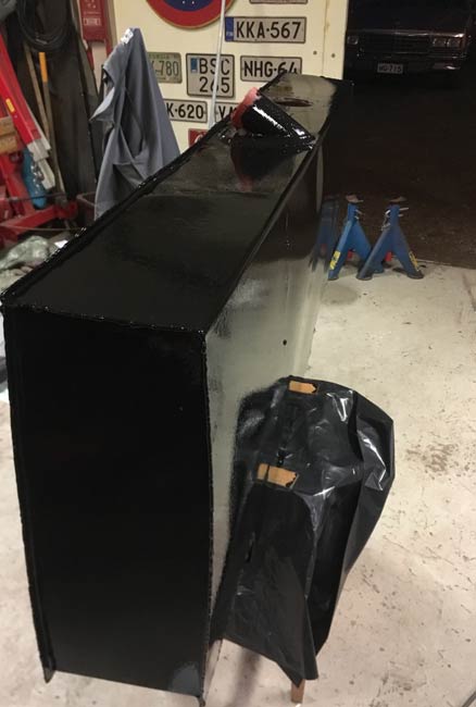

The fuel tank is done, but after leak testing it with dish soap and water, it started rusting. I
ground it with 180 grit on the D/A and sprayed on some red primer. I'm going to paint it black
when I have some more items to paint.

The tank looks good. The weed blower is a good idea and takes up less space than my old shop vac. Mine is mounted outside so noise & dust in the shop was not a problem. Yours looks like a net setup. Could a light dimmer switch be wired in to control the blower speed?
« Reply #250 on: September 11, 2023, 02:27:31 PM »
Thank you sixball. I'm going to use a transformer that's adjustable from 0 to 230 Volts, it can
take 8 Amperes, and works something  like an antique stick welder. A big hunkin transformer with a
 big wheel on top for adjusting the voltage. I'm assuming this will bring the rpms down, just have
 to hope the motor won't burn up from it. It has a really small impeller, so I think it will be fine.
Later last night I painted the thank and it's hold down straps with black industrial two part paint
and a roller. I felt too lazy
to start cleaning a spray gun and all that, and the tank won't be visible behind the back seat anyway.
I just love two part paint, still after painting quite a few cars in my life, even working in a collision
repair shop for a year, I'm faschinated by the way the paint feels the next day. Like glass, opposed
 to normal brush on paint that feels almost tacky the next day.
Anyway, I'll pour in a quart or two of  two sroke oil in the tank, and slosh it around for rust
protection, and put the tank in storage.

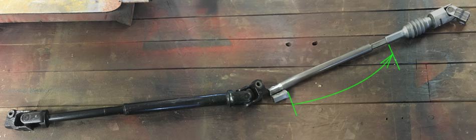

I got the steering shaft extension today from a friend of mine who did the turning and milling.
It's a Mercedes specific D-D size at some 17.6mm.
The green arrow shows the original end piece, and where it has been cut off.
I've drilled holes in the upper original part, so there will be four plug welds for added security.

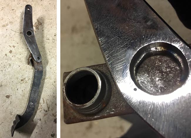

I brought home some material today, and made the brake reverser crank today from 10mm
Sheet. A bit more than 3/8" thick.
The hole was a bit tricky. Over and inch in diameter, and has to fit over that weirdly shaped
pressed tube. The plan is to make some kind of 90 degree under dash mounted master cylinder.
