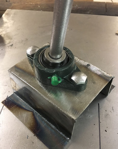

Using my hole cutting template thingy, I made a shifter assembly today.
I used a bearing with a spheric outer  race to provide the needed articulation.
The sheet metal part will be welded to the floor structure. In practice
this will be covered with sheetmetal and some kind of boot when it's
done, so not really visible.
The shifter is a simple thing to do, just what I need to get up to speed again.

If I understand this correctly, you are using the 2 bolt flange bearing as your pivot point. Overtime the housing will wear and become loose. Even faster if using a manual transmission.

62131, that's correct. and I gave it half a thought, but assumed it would hold up. We'll see, I'm
not really too excited about how it looks, so it would have to be covered by a boot. I might do
something more mechanical looking some  day. Thank you for the warning anyway.

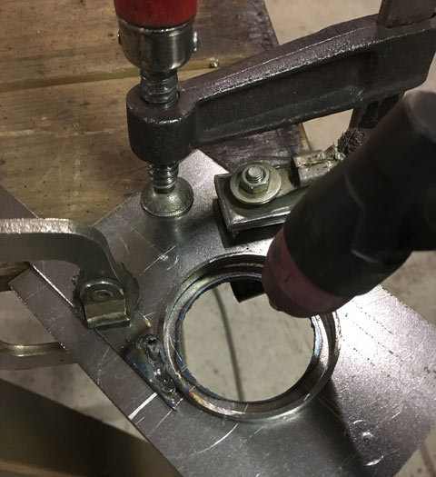

I got the whole shifty thing tacked in yesterday, along with the transmission tunnel piece that has
been missing. I tried it out, and the thing works nicely.
 Today I cut a couple strips and welded in where the gaps were too big to weld shut. Then some
grinding later it's done.

Looks pretty cool to me. Is that a grease fitting on the side?
« Reply #200 on: March 05, 2023, 03:37:50 PM »
chopper526 I guess it's a matter of taste. If I get a decent looking shifter lever in place
of that straight water tube it might look okay. And yes, it's a grease fitting. Maybe if it's lubed it
might hold up for a decent amount of time, we'll see.

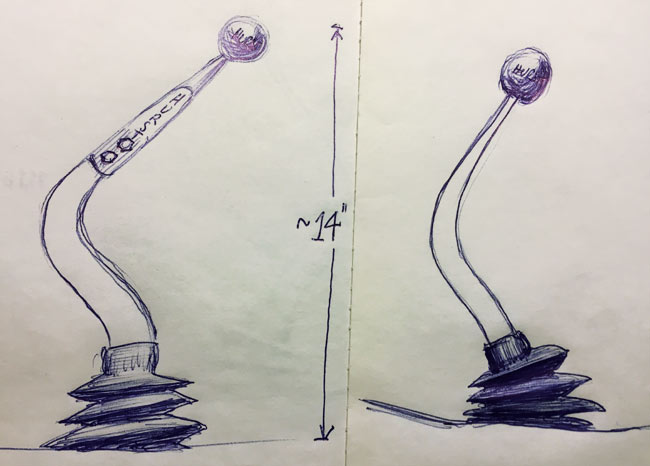

I dug through my stash of nice things and found the stubby shifter. Turns out it's 7-1/2"
and not six inches as I said yesterday. Still too short though.
I think I might fab up an own shifter lever, it will probably look better than trying to rat rod-punk it by
lengthening the short one and making a joint half way up.
Me finding an used Hurst shifter with the exact height and bend that I want. Cheap. Not likely to happen.
Lengthened version to the left and home made new version to the right.
Now if I can get some nice thick plate somewhere...

Essex_39. I have been selling bearings for a living for 38 years from agricultural to industrial. Just a little information where my knowledge of bearings came from. The grease fitting is there to lubricate the balls or rolling elements in other types of bearings. If you grease it, you will properly cause it more harm than good. The movement of the bearing in the housing is for shaft misalignment, I'm sure it will last for a while, but it will get easier to move overtime as it wears.

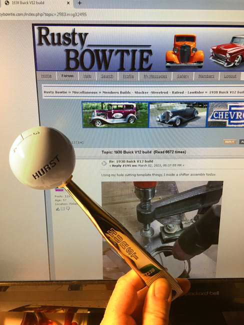

This shifter has been collecting dust in my barn for years...you can have it for free if you can use it.
Ed
« Reply #204 on: March 07, 2023, 09:36:22 AM »
Quote
Björn
Ed
Ed! That's absolutely fantastic, it has to be the closest you can get to what Im looking for!
Yes please, I can use it for sure.
Let me know how I can pay you for postage and all. You already have my address.
Thank you!
