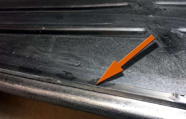

I'm planning on doing this the same way on the floor

Arrow points to the newly installed door seal profile on the floor. Just in case it's not self explanatory.

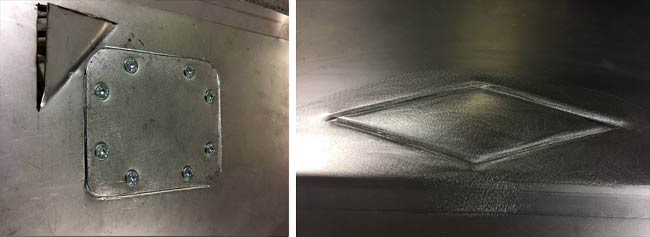

I cut out a piece of sheet metal, and rolled two bends in it at a friend's garage with his bead
roller, as the floor piece was 6" too wide to fit in my sheet metal brake. I also rolled a litle
hump in the center with his english wheel to clear the shock absorber cross member.
I rolled a diamond around the little hump, this time using my own little bead roller (right pic). I cut
out another hump to clear the air bag/spring mount, and started working on a little hatch to be
able to service the air bag and lines after the floor is welded in.

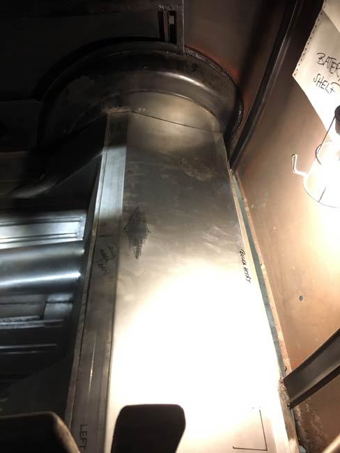

I got the rear floor done so far, holes are drilled for spotwelds, and the humps and hatches
are done, nuts welded to the underside of the floor piece. It's still not welded in, since I'm
undecided about fuel tank and battery placement.

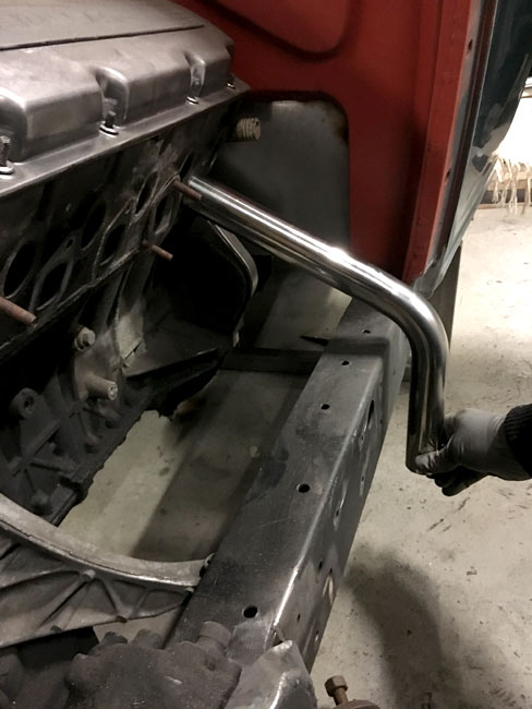

I got the header pipes I had ordered from a company called Botnia Bend.  12 header pipes
 bent to 62 degrees.
This is how they're planned to mount. Flanges are still not done.  Drawn and ordered though.
The pipes will snake down through the fender and back inwards, to a collector.
Bends below the fender will be unpolished water pipe. Everything in stainless.
Six polished pipes in a row on each side. Can't wait to see it done.
