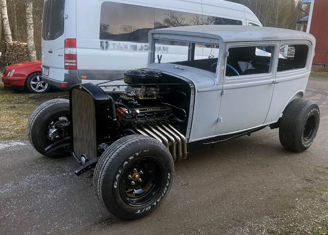

I got the tires on the rims today. Fun with another detail
that's making things look a tiny bit closer to done.
