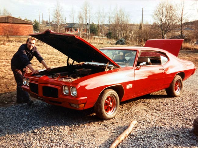

Finally, as my wife has been emptying her parent's house, she found some photos snapped
in the spring of 1991. Yours truly proudly posing with my 1970 Pontiac LeMans, working on
assembly after I painted it in my brother in law's garage.

« Reply #418 on: January 16, 2025, 07:39:55 PM »
Awesome picture with your LeMans!
