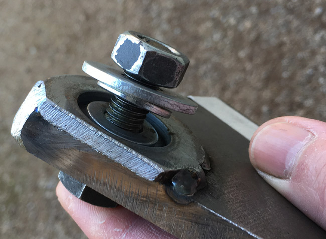

I started by making a tool for dimpling the switches a bit. I happened to have a big washer that I welded
 to a 3/8" thick piece of plate steel that I had drilled a 10 mm hole in. The sheet metal with a pre drilled
hole, or holes, goes in between the small washers, and the nut is cinched down tightly.
 This worked better than expected, I couldn't help myself before I made 11 holes, it was fun.

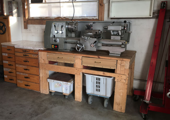

My uncle passed late summer, and the last time I had him turn some part for me, he asked if I'd like to get
his lathe when he "turns in his ticket" as he put it. Long story short, I bought the lathe from my cousins
and now have it in my garage. It took five days of work to make room for it with all the arrangements.
Good to be back to production work again. Exhausts now.

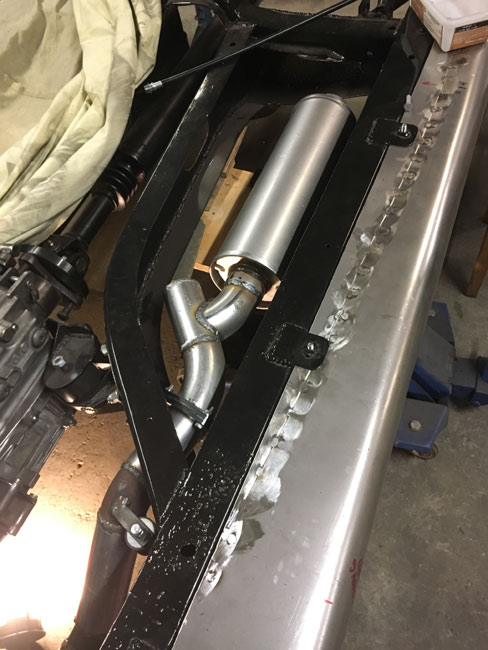

I had planned on some exotic Y connector between the headers, but decided it's too much work and too
little space (and too time consuming), so this is what we have now.
One hanger done, and the driver's side muffler is welded in. The other pipe will go to a valve and then
back into the same exhaust again. A cut out, but the exhaust and sound will exit in the normal exhaust.
I originally planned to go with 2" exhausts, but decided 2-1/2" is better. This means  the through holes
in the frame where the exhausts go are pretty tight. It might work out, since the V12 is supposed to run
smoothly.
