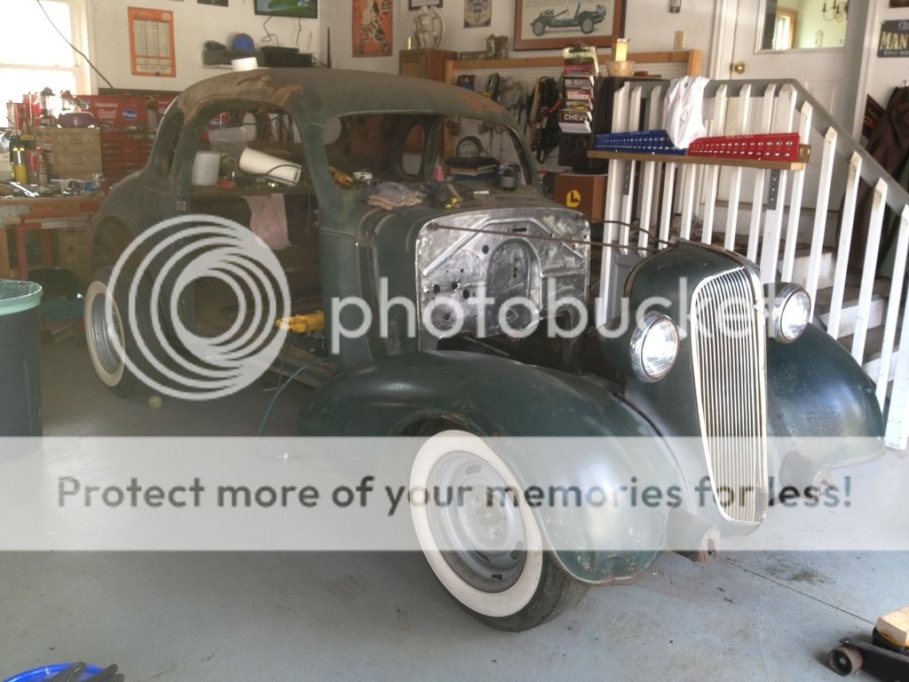

Update......I dont know which was more tedious.....drilling out all the rivets in the frame or filling in 50+ holes in the firewall.
Still need to shoot a base coat of primer on it here soon.

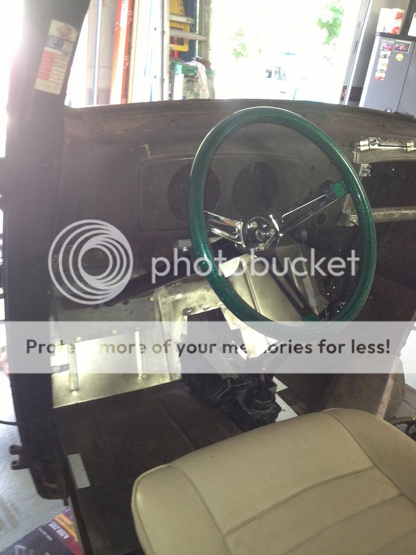

Scored a mint set of original early mustang buckets at a spring swap meet here in Connecticut this past Spring.  Had some 3/16 "C" channel bent up and got those mounted.
Now I'm moving onto a whole group of things somewhat at the same time.....cause you kinda have to.....toe boards, steering, pedals, e-brake, exhaust.....
It's really starting to get fun now!!!

Thanks All.......floors are just laying in position right now.  I'm throwing the motor/trans back in on Saturday Morning to see if I need a tunnel or not on the center section.  Then I'll start plug welding the floors and get the glove box section back into the dash now that I have repaired it.

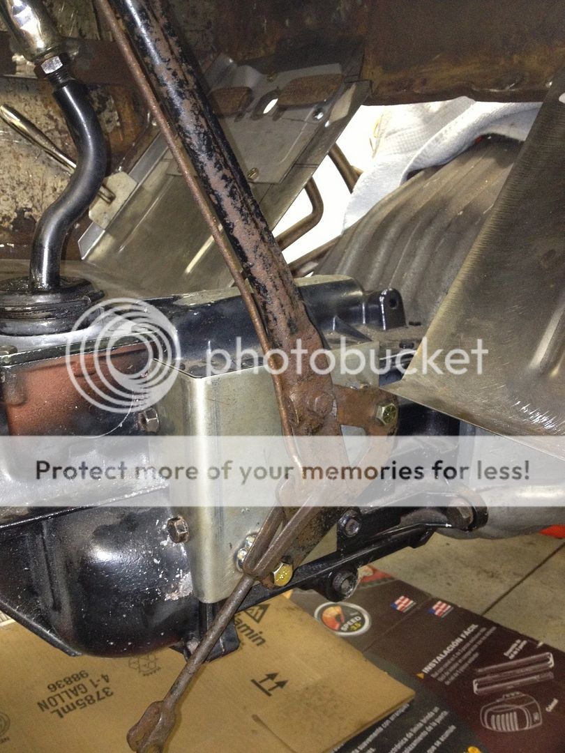

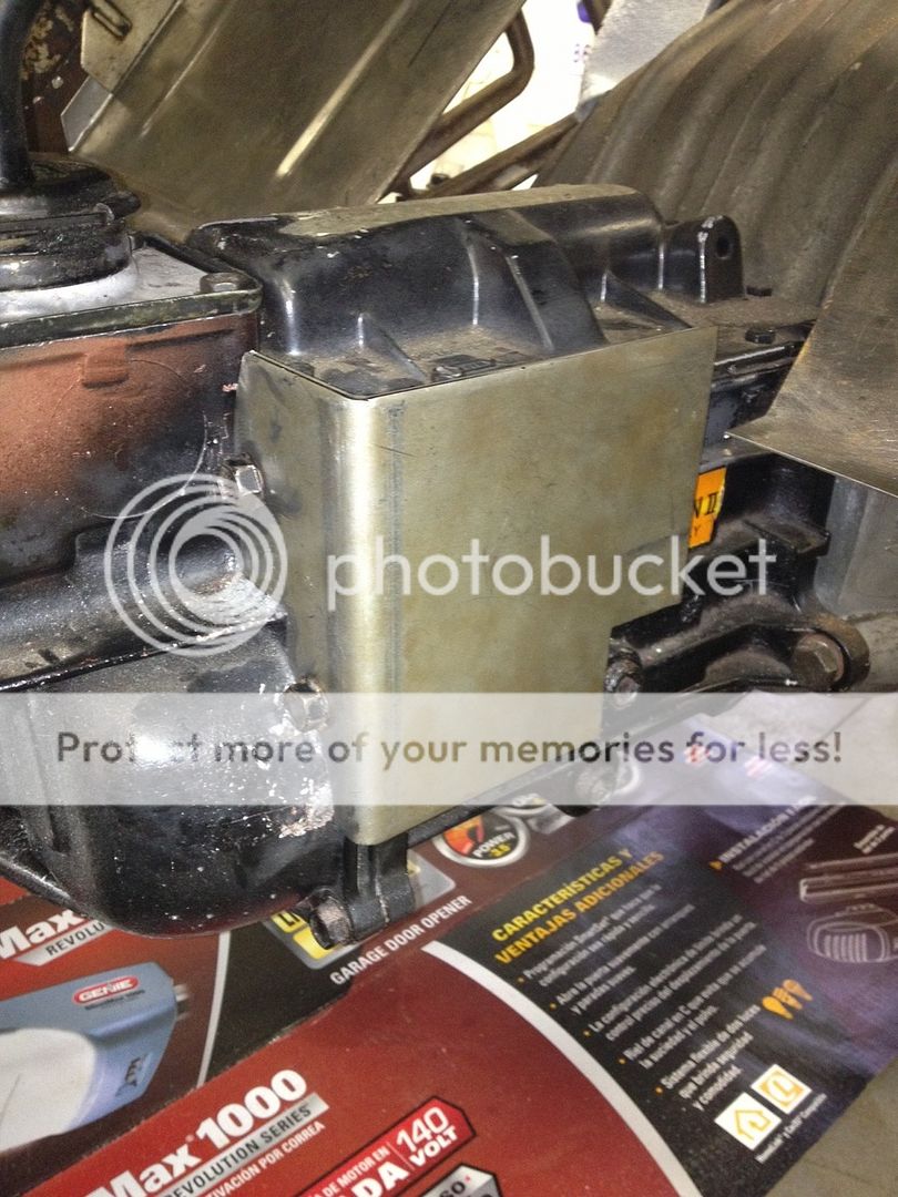

Threw the motor/trans back in and started working on the parking brake and steering.  I made a bracket which bolts to my T5 which allows me to bolt my OEM parking brake handle too.
Bought a Speedway steering column and a mount from ididit. which still allowed me to use the pedal access panel.
