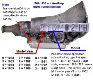

To be sure you get the better 1987 or newer 700R4 here is an ID chart:
