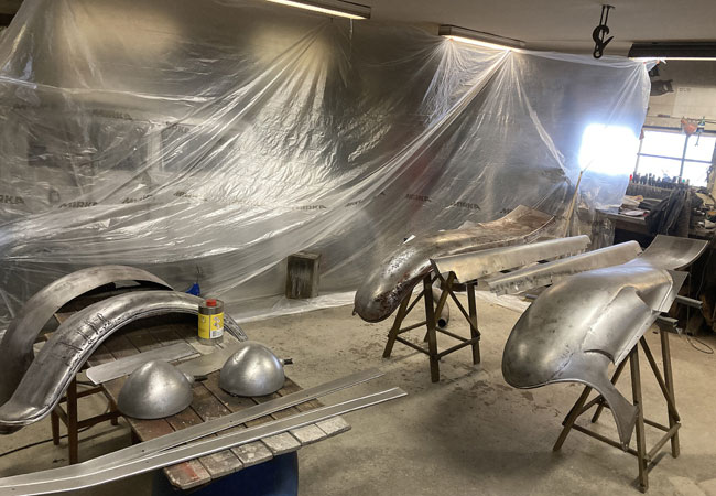

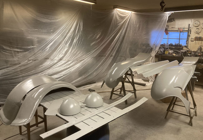

The garnish moldings were primered, ready for a scuff and final paint.
I removed all the removable sheet metal form the car and sanded the parts
with 180 grit.
I covered the body and engine with the same film that I hung up to part off
the painty side of the garage.
After washing everything with wax and silicone remover I sprayed a couple
coats of epoxy on the fenders, aprons, running board moldings and head light buckets.
Today I started block sanding, one of the aprons hardly needs any filler at all.
Sanding is not exactly fun, but it's progress. Tomorrow when the garage should
be suffuciently warm I'll start applying filler.

Since sprayong on the epoxy I?ve been applying filler and sanding
it back off numerous times, feels like more times than ?numerous?.
The fenders are very bad from a ton of welding.
I decided to give up for now, I don?t think I an able to improve
much more on the insides of the front fenders. They?ll be bolted
to the car for easier sanding when I?m done with the insides.
I sprayed on some red primer to get a look at the shapes for as
 long as it stayed glossy. A thick coat of epoxy and then fine
sanding will probably have to do. I?ve done my share of filler and
sanding work, even worked at a bodyshop for a year, but this is the
most challenging work I?ve done so far.
