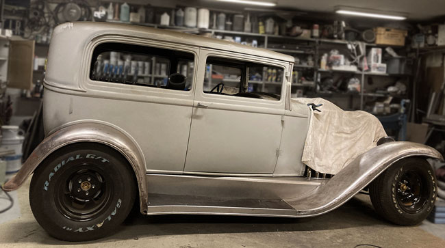

Yup-yup, going slowly forward again, the new fender edge tacked to the fender.
The swoop and the "depth" of the side looks much better than the previous version.

« Reply #534 on: January 31, 2026, 02:36:47 PM »
Thanks, sammons
It was fun once the parts were tacked together.
 I didn't expect it to take this long to make the
second one, it's been exactly a month since I
started on this fender.
Now it's done anyway.

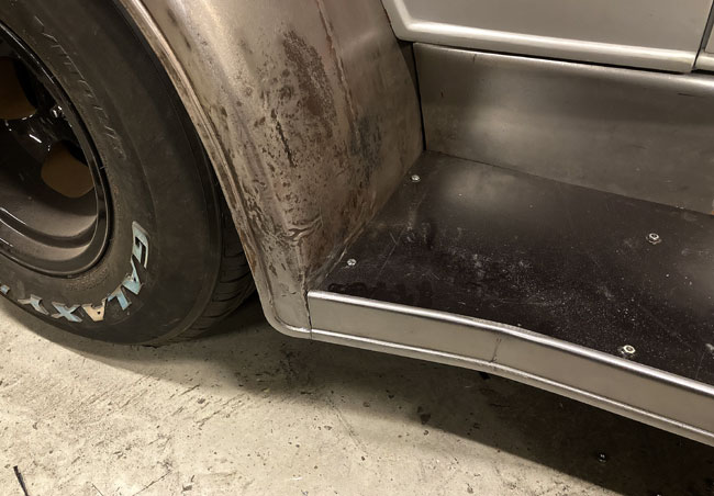

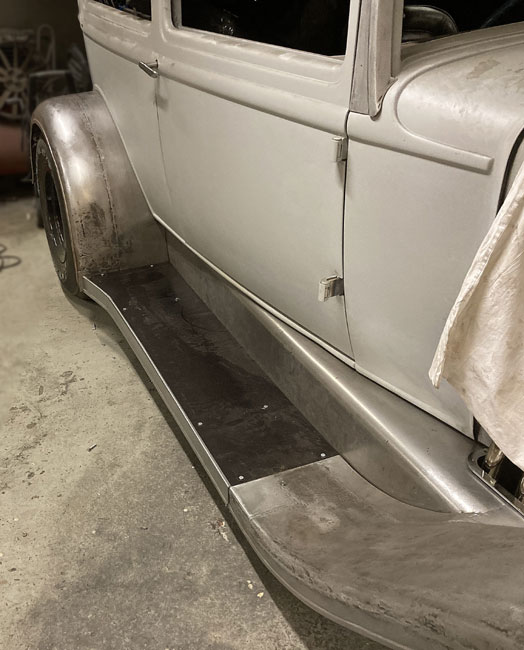

After a few days of recovering from the shock of getting the front
fender done (read: family and chores), I continued with the right
hand side running board and its associated parts.
I cut out  the parts I had made before and went to a shop
and used their big sheet metal brake to get the running board
moldings done.
I bent the molding to fit the cut down to size runningboard.
This made the sideview  feel more finished, since the front fender

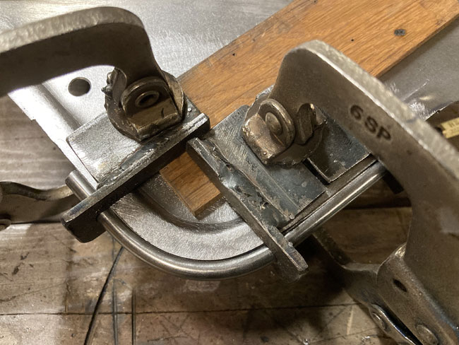

seems to continue along the runningboard.
I then made a press tool to make the last little piece that is missing
on the bottom of the rear fender. Pressed in the bench vice.
Made a 1/4" round bar piece fit and welded and welded and sanded
Some cutting, welding and grinding later the result is pretty much
what I had envisioned.

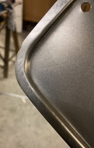

  • Posts: 422
« Reply #539 on: February 15, 2026, 05:13:09 AM »
Learning by doing. I made the little bottom piece for the front of the left
Rear fender. This time the shape came out flawless with no hammer
marks. Fun when you can improve on work and results.
Simple improvement, I pressed the edge instead of hammering it.
The right hand side is kinda all done now. I welded a piece of flat bar
to the front inner edge of the rear fender. Then drilled holes
through the apron and the flat bar for three bolts.
I also made five small mounts along the runningboard for the molding
and got it all bolted together.
Small but visual progress, it's fun when you get things that shows done.
Now one side is all but ready for epoxy and bodywork.
