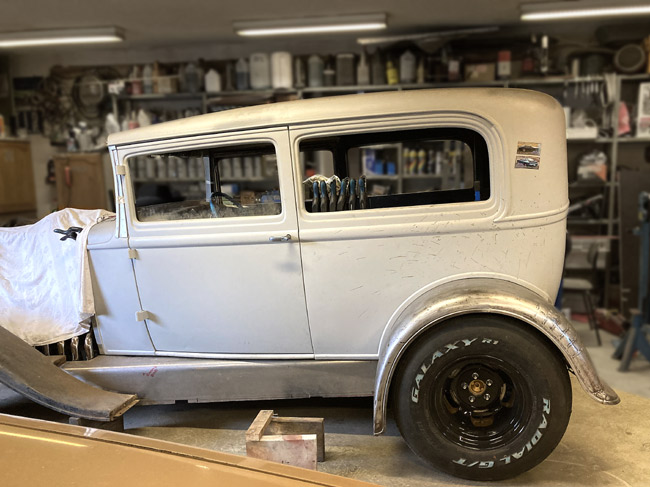

So, back in the shop I continued on the rear fender, cut it down a bit where it had a bit of a bulge
and welded things together again, ground the welds and rolled it on the English Wheel today.
After some hammer and dolly work it looks okay, except for the last two inches in the back, which
will be adjusted later to get a similar shape as the other fender.

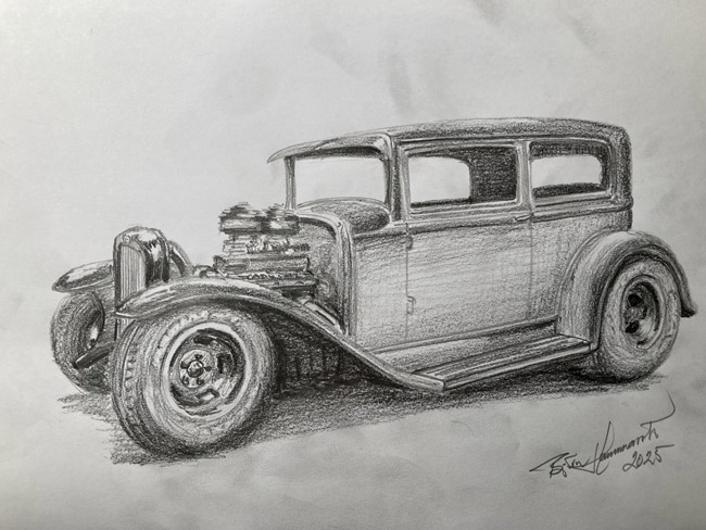

I've planned to draw a concept drawing for the longest time, all since I bought the Buick back in
the fall of 2019. I finally got one done friday night.
The head lights are still missing, I think I'll just try to get them mounted as low and as  far back
as possible, when the front fenders are done.

Thats another thing i miss, sketching. I'm lucky to hold a pen long enough to write a check, poor gals at the bank trying to figure out what i was trying to write😁  Your sketch looks nice!

I've been at it in the garage a few fairly short evenings, making some progress on the endless fenders.
Last night I felt I was doing good, had it all welded, ground and done, save for a little piece in the front
that I'm planning on doing later, to have it connect nicely with the running board.
New fender edge pieces, inside and out, even the tail lip done. Looked pretty good to me right then.
Today after dinner I went out in the shop and was going to start working on the left hand side inside
fender edge, when I realized that I have to start over. The fenders don't look the same, and I much
prefer the left fender, as the right hand one looks too tightly tucked behind the wheel. If you look
closely you might notice that the wheel sits a bit further back on the right hand side. The body is not
square in a way that I think would be impossible to not be a factory defect.
Fact remains, so I just have to make the best of it.
Two steps forward, one back...

So, the obvious thing to do is to mount the running boards and get the aprons ready
to fit the fenders. I measured the running boards and ajusted so they were parallel,
then made a runningboard to rear fender mount from some angle iron, adjusted
things till all fit, drilled a bunch of holes and bolted everything down on the right hand side.
The driver's side is just loosely fitted.
The right hand side looks pretty good and the whole car seemed to grow a bit when I
got the apron and running board mounted.
The running boards are still too wide, and will be cut down a bit, the right hand one is
also still too long and will be cut down later.

I mounted the driver's side running board  yesterday. Makes me wonder how many times i
have mounted and taken the fenders off the body.
Today I started tweaking the driver's side fender, and noticed that when you push the inner
fender edge forward to make the fender line up with the other one, the outer fender edge
shifts outward, making the fender look like it's sqewed. This made me cut through most of
 the fender to adjust it in the opposite direction of the reaction.
It's kinda endless, every adjustment makes other parts of the fender go out of adjustment,
making it a lot of back and forth.
I finally got the fender to look like it fits decently, and turned to the right hand side fender.
I cut it up at multiple spots to get it to look a bit more like the other fender, measured and measured.
I finally cut the back part of the fender off, and stretched it 15/32".
Now it looks better, I might leave it like this. It's just tacked in place for now, I'll decide tomorrow.

Last night I got another new piece of fender lip welded to the right hand fender that I, once again, had cut up and sliced as per my last post. This time it looks okay, and It's good enough.
I've put a couple evening's worth of work on the driver's side fender too.
Very slow progress but any day now, I can go on to something else. About time.
