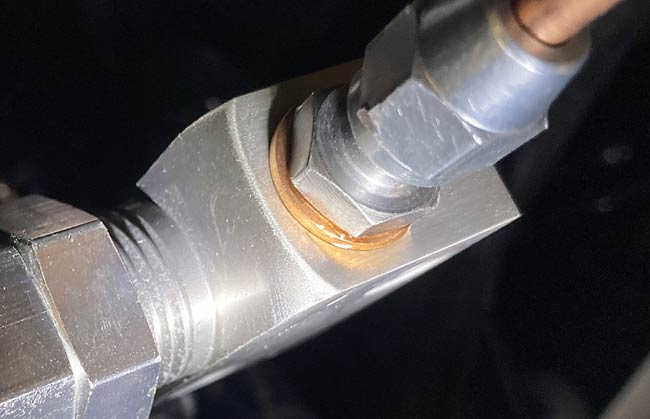

This is the brake proportioning valve, and for some reason I just could not get one of the brake lines
to seal. I remade the double flair a couple times, I got it better, but it still kept weeping fluid.
I had a shop make a new line with their high end tooling, and finally got it to seal, Then I noticed the
 cupper washer on the other end was weeping too. I took out the fitting, filed it a bit shorter so it
wouldn't bottom out before the washer got crushed tight, mounted it using a new washer and
probably too much torque.
Now it's not leaking anywhere, and we finally have brakes!

The day after I made my last post, the proportioning valve was weeping brake fluid again. I changed the
copper gasket to an aluminum one, then with no improvement, changed o a new copper one, and still leaking.
I wrote to the speed shop I bought the proportioning valve from, and asked for advice.
 They sent me another valve with no questions asked. When that valve too leaked from exactly the same
copper seal, I got annoyed, this has to be an issue with these valves.
I called and sent them this pic along with a couple other ones. After less than an hour I got a text saying
that my new Wilwood (more expensive) valve was sent along with a paid lable for returning the two bad valves.
That's what you get for trying to be cheaping out to save like $45 on a project that costs tens of thousands anyway.
Along the way, in desperation I bought a really good brake line double flairing tool. Next time it will be fun to make
new brakelines, I took out and made three new ones just to try the tool out. Much neater results.
So now for the Nth time nothing leaks, the brand new Wilwood proportioning valve is mounted and I
have depressed the brake pedal for some time, still not finding any leaks. Maybe one day I can get
the brake system bled too, a task that I was going to get done two weeks ago.
Leaking brakes is not a big deal, but when I seemingly couldn't get it fixed, it took a huge chunk out of my inspiration.
It's not like this is my first time making a brake system...
Two weeks all but wasted, but hoping for no leaks tomorrow, a deep breath, and then to get back up to speed.

TFoch, This vendor did it all the way!
I got the new Wilwood brake proportioning valve, (to which they had had already mounted the
right hardware to fit the brakelines I made earlier for the cheapo valves) as I mentioned earlier.
No leaks. After checking that everything is good, I sent the bad valves back to the vendor  using
the prepaid ( free to me) label.
I messaged them yesterday, sunday asking how to pay the balance. I got an answer immediately
telling me that I can keep that as pay for the unnecessary work with the no good valves.
How amazing is that?!
