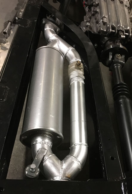

Continuing on the exhausts.
Here's how I made the plumbing, I guess it's pretty self explanatory now.
As always  with cars, when you are done, you have to do it again on the other side.
Exhausts done as far as I can before the body is back on the frame. The floor wraps pretty
tight around  the rear axle, and I want the exhaust to go over the axle as close to the center
as possible. Hope my plans work in practice.

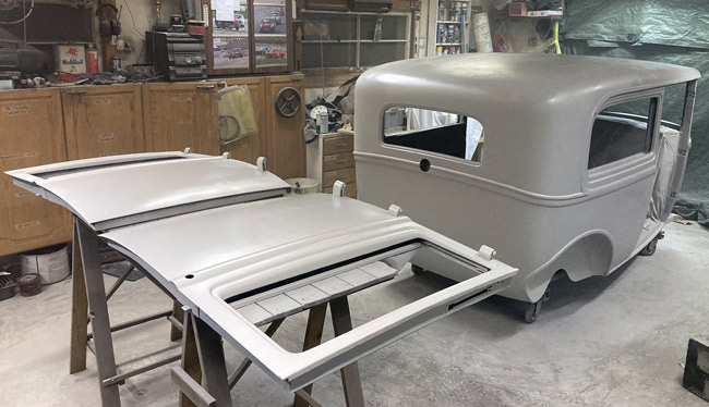

« Reply #395 on: October 27, 2024, 03:16:31 PM »
Body and doors sprayed with epoxy.
I bought a metric shi#!load of filler, there will be a lot of filler work on this body in the wake of all my hammering and welding.
I got the shape pretty much dialled in where the Volvo V70 roof meets the Buick roof line today.
The doors are ready for the next layer of epoxy, which I use in lieu of sanding sealer.
