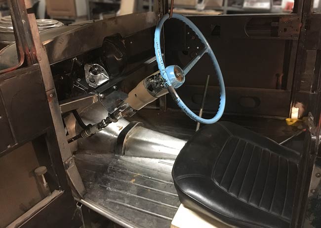

A couple days ago I worked some more on the column drop and could bolt the column to the new
tube between the A-pillars. It sits right now, the steeringwheel is nicely aligned about where it
needs to. I also had the brake pedal in the right position, and tacked it in good, with nice beefy
tack welds.
Right when I felt content with the result and was done, I came to think that I can alter the angle
of the steeringcolumnl to get some more room for the gas pedal. Oh well, I'll do that tomorrow...
Because reasons, it took me a couple days to get back to it, and today I cut the column loose off
of its drop mount, moved the nails in the two by eight on the floor 13/16" to
the left, and turned the column a bit so the steering shaft points a bit to the left, and the wheel
is again straight. Using the tilt column really is a saver. Then I welded the column to its drop mount
again in its new position.
I made a colum extension from thin (5/64"") wall one by two tubing all the way to the firewall, so now it's sturdy.
Then I ground away the big tacks on the brake pedal mount, and moved the whole thing to the left as
much as the U-joint was moved. Tacked in again, now In the right position. The result is a little bit more
room, which is sorely needed.
This is in principle how I "misused" the tilt function by rotating it.

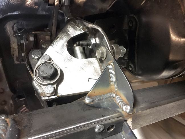

A good day in the shop today. I made the final mount for the brake pedal assembly.
Then started working on the clutch pedal. The Dodge brake pedal mount is now hung
 in two mounts, one still to make and weld to the firewall
I cut away some of the old mounting points and drilled holes for the last mount, then
welded the clutch master mount I made earlier to the top of the pedal mount.
I was able to use the eyelet from the Dodge push rod (Arrow),and welded it to an M8 bolt
that I cut the head off of. Then the bolt for the pushrod that goes with the eyelet, for
a slop free installation.
Some cutting and grinding still  to do to make it all look a bit prettier, then into the blasting
 cabinet and then paint.

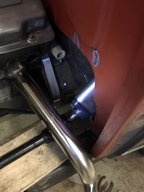

The brake master still hadn't been test mounted, and of course there was some cutting to
be done. The cut was made as high as possible, and the result is a 3" space above the
master brake fluid container for filling fluid, so no issue with that.
The cluch master has a remote container, I guess that one's just going to protrude through
the top of the dash for easy access
